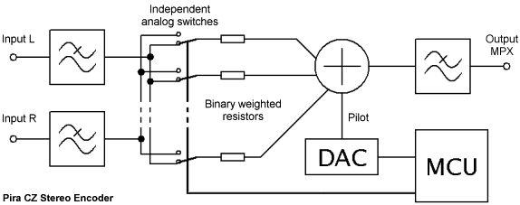

This stereo encoder is a halfway between analogue and digital processing. It combines the best from both domains to provide high-quality and easy to build device. The sampling frequency used in this stereo encoder is 97 times (!!!) higher than the pilot tone frequency. This makes very easy to reject all spectral residues around the sampling frequency without affecting the main signal characteristics. Using of a microcontroller allows to build this stereo encoder with reduced part count and get excellent results in real operation.
This stereo encoder advisedly does not contain any preemphasis circuit. Remember the key fact: a compressor/limiter/clipper device must be always present between the preemphasis circuit and the stereo encoder or modulator. Only this configuration ensures loud sound without exceeding the maximum frequency deviation limit (75 kHz). The stereo encoder is designed to provide really good sound. This always needs to use the compressor/limiter/clipper device where the preemphasis is precisely assured. The Pira CZ Compressor/Limiter/Clipper is highly suitable for this task.
Basic block diagram:

Kalo yang noise dari sumber audionya maka berapapun oversamplingnya tidak ada pengaruhnya. Karena noise MPX biasanya  berasal dari harmonisa/kelipatan ganjil dari frekuensi pilot 19 kHz juga bisa dari frekuensi 38 kHz.
Contohnya bisa dilihat sbb:
http://rbsfm.ej.am/joomla/index.php?option=com_content&task=view&id=523&Itemid=29
Contoh diatas adalah akibat dari harmonisa frekuensi 38 kHz. Dengan memperbanyak oversampling maka harmonisanya akan lebih sedikit. Jadi kita bisa menambah volume untuk dikirim (dengan indeks modulasi yang sama).
