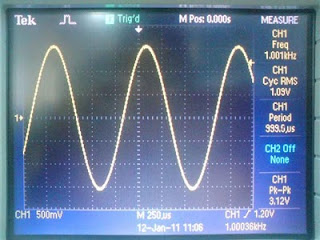

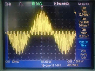

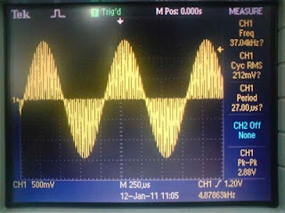

Hasil pengukuran Mpx 16x, input balance, low impedance out, 38khz -117.5dB
PHASA 19KHz
OUT 19KHz
OUT 1CH, 1KHz, L ATAU R
OUT 1CH, 1KHz, + PILOT
OUT MPX 16X, INPUT 1KHz, L = R,  MAIN CHANEL TANPA DISTORSI 38KHz.
OUT MPX 16X, INPUT 1KHz, L = -R,  SUB CHANEL / DSBSC.
