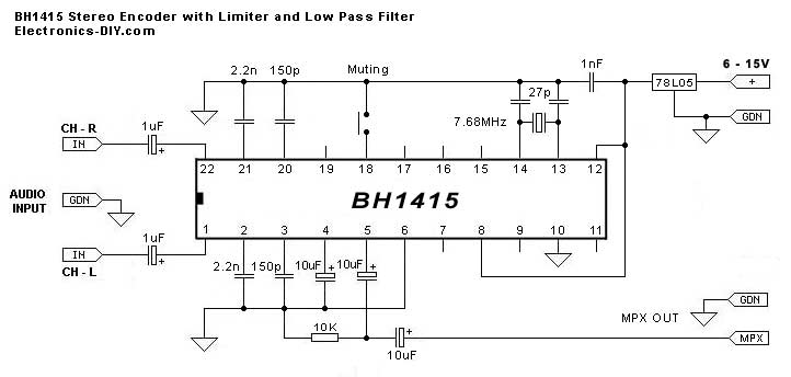

ic number, then this work.  Ok  Ok  OK !    ;D   in Thailand  .... Sale 200 Baht.
Thank you suggested.

Audio In     CH- R/L   C = 1uF  Changes is  .... 10 uF 16V
X-TAL  7.68mhz   Changes is   7.6mhz
  :-* Audio Clear  :-*
  :-* Audio Clear  :-*
Good Job ...!
