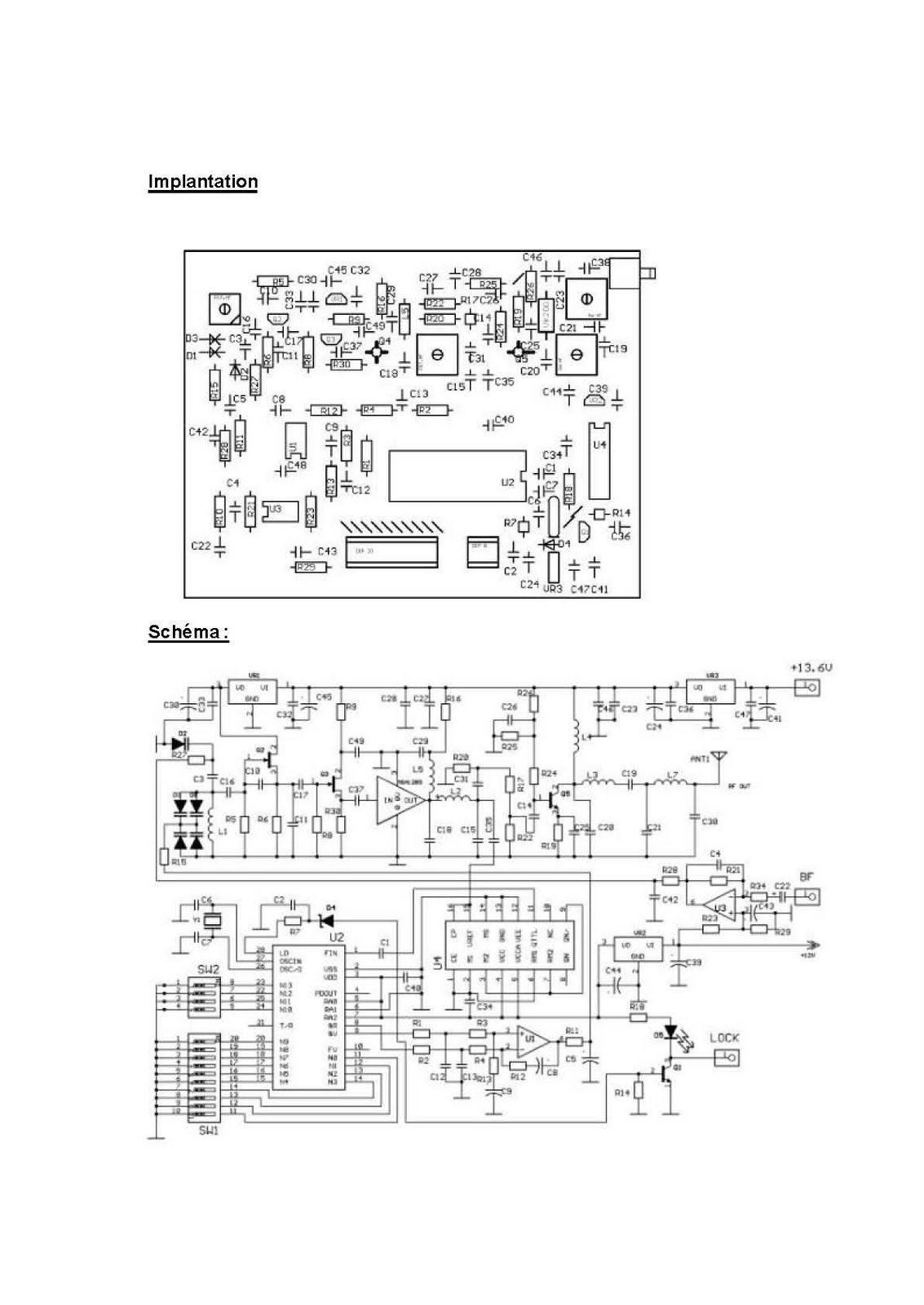

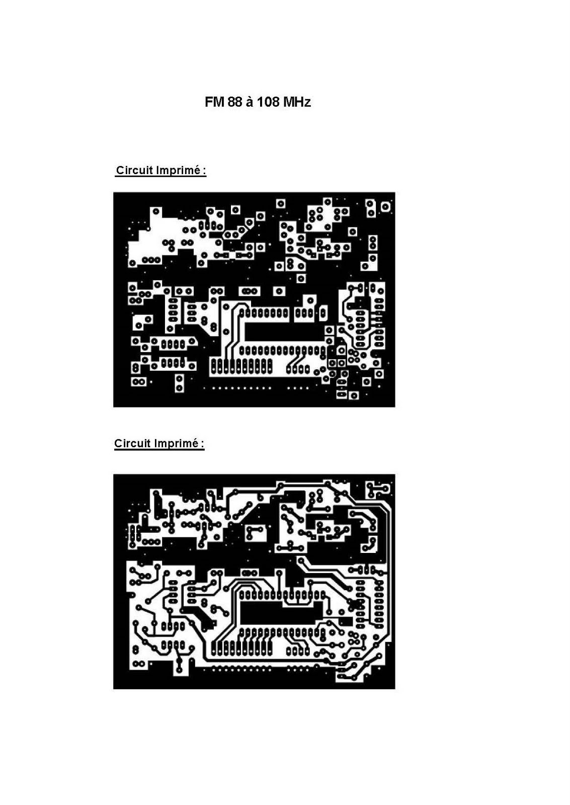

tolong koreksi ya kalo ada kesalahan

Must not use this IC, you could use ic equivalent like 74f112 for devide 5 or 2x74f112 for devide 10, because datasheet 11C90 prescaler only devide 5, or 6, or 10, or 11 must not be motion in range frek  650mhz...
